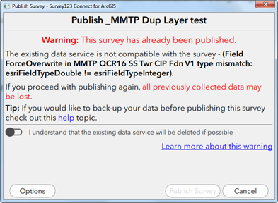

Changed an “bind::esri:fieldType” from esriFieldTypeInteger to esriFieldTypeDouble
Accepted the Warning and Published…

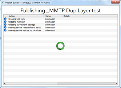

Publishing hung at this screen (hit red X to kill after a while):

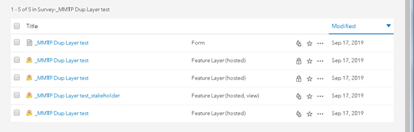

Duplicate Feature Layer created, but not shared.

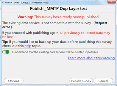

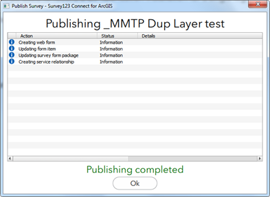

Accepted the Warning and Published again…
Publishing completed successfully.
A third duplicate Feature Layer created, but not shared.
Data collected by survey owner goes into top unshared service.
Data collected by survey user hangs on send. Have to kill Survey123 3.5.177 on IOS.

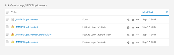

Manually Delete 2 extra Feature Layers. Error:
Some items were not deleted because they are delete protected or have dependent items.
Delete Stakeholder view.
Delete bottom Feature Service
As owner reshare Viewer rights for user group.
All seems good again…

During republishing, I've been stuck at the publishing screen for 30 minutes now. There are about 1,400 records in my feature layer. Is it normal to take this long deleting the service item, or should I abort and try starting over or try copying the survey?
JamesTedrick
Esri Esteemed Contributor
Hi Brian,
This most likely means there was an error that was not caught by Survey123 during the deletion process.  One reason is if there is a view attached to a feature layer.  You can go into your item contents and manually delete the view and feature service (normally you can identify that by the last modified date).
