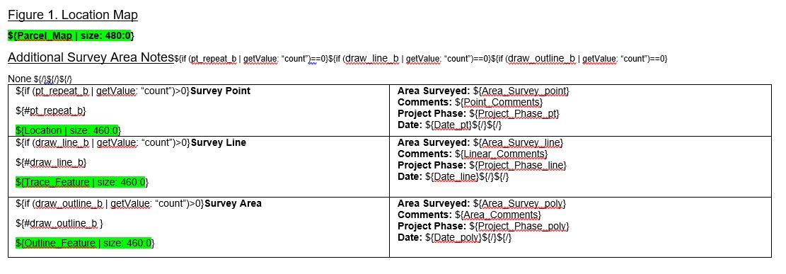

Hi all, I have a report with 4 repeats--one for each shape (points, lines and polys) and then photos. I have gotten everything working in except the maps I want to include: 1 for the main record, and then one for each shape, if present. If I try to just get the main record map to generate, I get errors of "failed to print. Runtime.callFunctionOn timed out", and "failed to printIndividual". And then when I try to just get the repeats in there, it skips over those records during the report generation all together and exports "but with issues". My syntax checks out so all of these occur during report generation. The bits with the issue is highlighted green in the below screen shot.
Any help anyone could provide would be much appreciated!

Am getting almost the exact error. Failed to print map for ${location}. Runtime.callFunctionOn timed out. Any help would be appreciated.

Hi Gavin, I did not really. I opened a ticket with ESRI but they couldn't identify a specific issue/culprit. The solution they suggested, and what ultimately ended up working, was to wipe and republish. After doing so, I am able to produce reports with maps but obviously it wasn't ideal.
