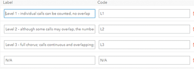

In Survey123 Summary reports, is there a way to report codes rather than labels from "Select One" questions? For example, from the domain list of values below, "L1" rather than "Level 1 - ...". The full label is unwieldy for reporting, but necessary for the field crews.

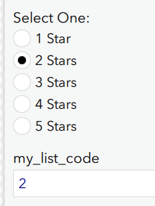

In that case, you will need to do the calculate in S123:
Just reference the calculate in the Feature Report instead of the select_one.

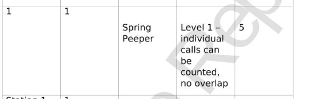

Dawn_Bondy
It seems that doesn't work for summary sections. Sorry, I should have specified.
Dawn_Bondy
That was precisely the solution I was trying to avoid. Thanks for confirming it can't be done in the report template itself.
