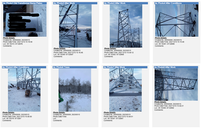

Hi, sorry this is an old thread, however images in repeats can be put side-by-side in a tile view by formatting the repeats in a text box in the feature report template. This allows data content to be added with the photos.  Below is what we have been doing for our photos when we want them in a tile view.
Side by Side PhotosSide by Side Photos

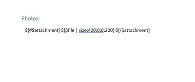

I have also been struggling with this. I have found that using the following syntax in a text box gives me the desired side by side photos. Note the spaces matter in between to give you photos space! Good luck!

Old thread, but hopefully this helps anyone who ends up here. I got the text boxes thing to work for displaying pictures and captions in a repeat horizontally.
Insert a text box in Word, set the text wrapping to "in line with text". That part is important. Put your opening repeat tag in front of the text box and the closing tag directly behind the text box on the same line. That part is important too. In the text box put the image and any data attributes on separate lines.

place them in the same line :
${#$attachment} ${$file| size: 250:0} ${/}
