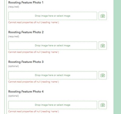

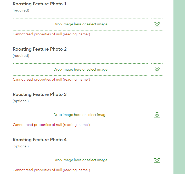

I am trying to show photos that are within a repeat in a survey123 web form. When field users re-open the form (for another site visit ) the photos attached to the repeat do not display showing the below error:
"Cannot read properties of null(reading'name')"

Hi, we've had similar issues and eventually figured out we needed to Upgrade Attachments in SDE after it has been enabled.
We have to do the following now: for every new layer where attachments are enabled in SDE, run 'Upgrade Attachments' (Data Management in Pro), stop and start (or even republish) service to ensure attachments show in Survey123 web forms when viewing.
Hopefully this helps you too.
