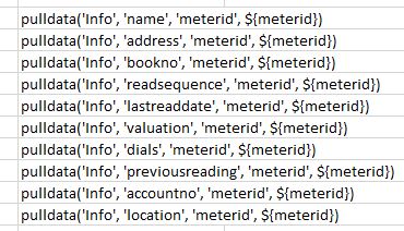

It about water meter IDs;
That's the schema I use in Survey123:
That's the calculation for the other fields:
That's the pulldata source (CSV file):
As you can see item number two should start with a 0, however its not displayed in the CSV. Consequently, it's also not working for the survey app as it can't find a matching record.

Thanks for the additional details.  Is the CSV coming from a database of some form?  If you open it in a text editor (before opening in any other program), are leading 0's present?  If they are, I would not touch the CSV with MS Excel unless you specify that the ID should be text when importing - it will attempt to auto convert the IDs to numbers.  If the 0's are not present, you may want to work with whatever is generating the CSV (alternatively, treat the ID as a number by using the number() function in pulldata on the form).

Everything is sorted now. The solution is simple: Just don't open the CSV with Excel before you publish the survey.
As soon as you open the file in MS Excel all the leading '0' will get deleted... Odd..
