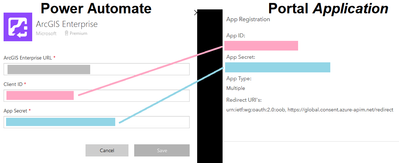

Wasn't able to get the Power Automate ArcGIS Enterprise connector to work.

Did you get any errors with the connector? I am trying recall making the ArcGIS Enterprise Connector, and I don't remember there being anything too involved (at least compared to the Custom Enterprise connection, which you indicated you've already made).
If it isn't anything on the Power Automate Connector side or the Portal application side, my only thought would be a CORS issue (but if the Custom Connector is working, so to should this one).
I know this deviates a little from your initial question, but I'd think that this new connector should do what you are looking for. Assuming we can get it working.

We've tried to configure the default ArcGIS Enterprise connector numerous times and been unable to get the connection created.  Its taken us months to get the custom connector working even with assistance from local ESRI office.  There seem to be security blocks on the WAF which affect our ability to get ArcGIS Enterprise to behave as its supposed to.

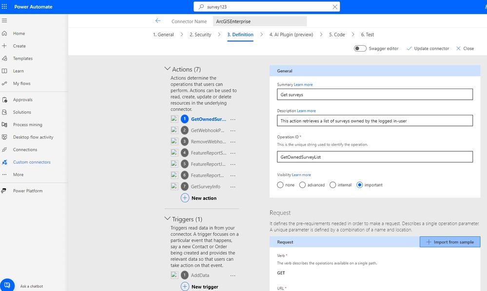

Screen shot below shows configuration screen for the ArcGIS Custom Connector..  Are there other Actions that would allow a 'Post to a feature service' that can be added to this connector, or that would be available if the default ArcGIS Connector was worked?

The Custom ArcGIS Enterprise Connector (pictured above) only has the capabilities you see listed under it. It isn't possible to add any additional functionality to this connector. That is where the confusingly named ArcGIS Enterprise Connection comes in, by allowing you access to things like Feature Layers.
