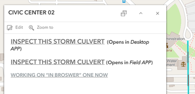

I created a Survey123 with Web Designer which has a map and singleline text question (like geopoint in Connect without the pulldata) that is linked to a Web Map with a Popup that has a Link to the S123 Form just created.  All is good when opening in a desktop app 🙂
arcgis-survey123://?itemID=xyzx&portalURL=https://portal.xyzx&field:fieldname={attribute}
It returns the attribute (which does have EncodeURL in an Arcade expression due to underscore in attribute name.)

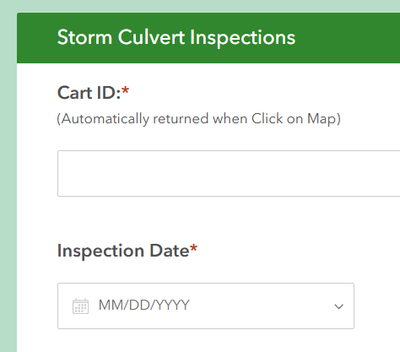

HOWEVER, it does NOT return that attribute IF opened in a Browser and just gives the "suppose to be automatically populated text from attribute clicked in map like the desktop app does" as a Blank Text question that still Needs to be populated.  I believe I am using the correct link:
https://survey123.arcgis.com/share/xxxitemIDxxx?portalUrl=https://portal.maranaaz.gov/portal.xyzx&field:fieldname={attribute}

More info, just so you know...
Popup in Web Map
(DESKTOP APP)
arcgis-survey123://?itemID=072xxx57e&portalUrl=https://portal.xyz/portal&field:click_on_a_storm_culvert={expression/expr0}
(FIELD APP)
https://survey123.arcgis.app/?itemID=072xxx57e&portalUrl=https://portal.xyz/portal&field:click_on_a_...}
(BROWSER – and only returns the S123 Form WITHOUT automatically returning the Attribute, like the APPs do without any issues.)
https://survey123.arcgis.com/share/072xxx57e?portalUrl=https://portal.xyz/portal&field:click_on_a_st...}
The Arcade Expression 0 takes care of the special character (underscore) used in the field attribute “column” name with a EncodeUrl to remove the “20%” for spaces. All good there.
APPs
BROWSER
Our S123 and data is in an on-prem server (so the portal is needed), and I changed with ?/&’s as needed. And checked that it is all Shared with Everyone (all FLs, etc.)  I am at a loss now.

Yep. It works the same. Also attempting without the &field: and it is the same. Also attempted on several browsers and with clearing cache and private/incognito mode, and way too many other things. Also been since Friday on this one so on different days as well.  No luck.  I so want workers to be able to open in a browser without downloading or logging into an App. Thanks for such a quick reply!

Hmm...so when I change it to portalURL (in caps) it makes me log into our portal (Enterprise portal BTW) and then gives a login error. When I leave it in portalUrl (as documentation and as link in S123 Web Designer has it) it opens the Form in a browser but does not automatically fill the singleline text with Cart_ID as it does in the App ones.  I am a bit frustrated at this point.  Thanks for all your suggestions though! And I am here if you have more. 🙂
