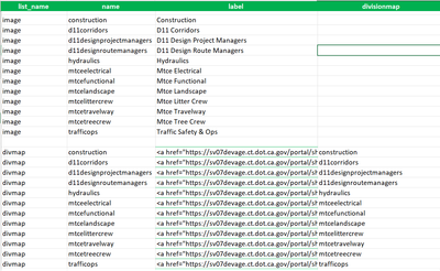

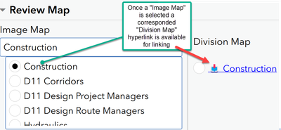

My goal is in my survey form is to show a hyperlinked images’ list that are stored in my enterprise account.
Here are some screen shots for better understanding of my problem.
Note. everything works beautiful on Survey123 connect, the problem is when the form is published everything gets wonky.

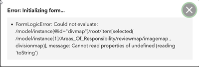

Here is the error message:

No, the users do not need to answer the "divmap" question. The "divmap" is to hold the "url' for the clickable image.

Yes, the 'divmap' is a 1:1 match for the 'imagemap'. Could you show me  the calculation alternative?

The field app and web app often times act differently with html.
Do users need to answer the divmap question or are you just using it to display the Url?  As an alternative, you could set up the URLs as a series of note fields and have them relevant based on the answer to your imagemap question.
It appears that divmap is a 1:1 match for imagemap. If so, and users need to answer both you could use the note fields to make a calculation to capture the answers for the divmap question.
And thank you for the suggestion in setting up the 'urls' as a series of note fields, it did work.
