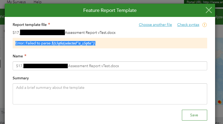

I have a feature report template for a Survey123 form that uses the following syntax to create a checkbox for select_one type questions:
${select_one|selected”option”} Label / Text
The error message I received was:
Failed to parse ${select_one|selected”option”}.
This syntax has worked in the past but stopped working around the time of the latest update, so I assume something has been changed.  I have tried with different questions etc, so it is not a typo error or anything.  The format that used to work correctly no longer works.
This is the outcome I am looking for:
Apologies for having to black everything out, need to protect the privacy of the survey owner.
Thanks for any response.
JamesTedrick
Esri Esteemed Contributor
Hi Andy,
The format for a selected option is
${fieldName | selected:"code_value"}
Note the colon after selected
