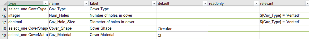

Hello,
I have created form using XLSForm. But as you can see in attached form, there are too many question. Is there any solution that if first question in group is yes, others follow to yes?
KorySteele1
This may not work in your situation, but if you want the next question to always be yes when the previous question was answered with yes, you could simply set the default to yes.  Of course the user could still change the answer to No if need be, but if you're trying to save clicks on such a long survey, it would seem making those follow up questions default to yes would serve that purpose.
Below is how I use both default and relevant for a manhole inspection survey.

KorySteele1
What you want to use is the relevant field, like this

Thank you for response. My intention is "If first question is yes, next question is automatically yes". Could you pls help me
KorySteele1
TsedevGankhuyag
Solved. Many thanks for your assistance.
