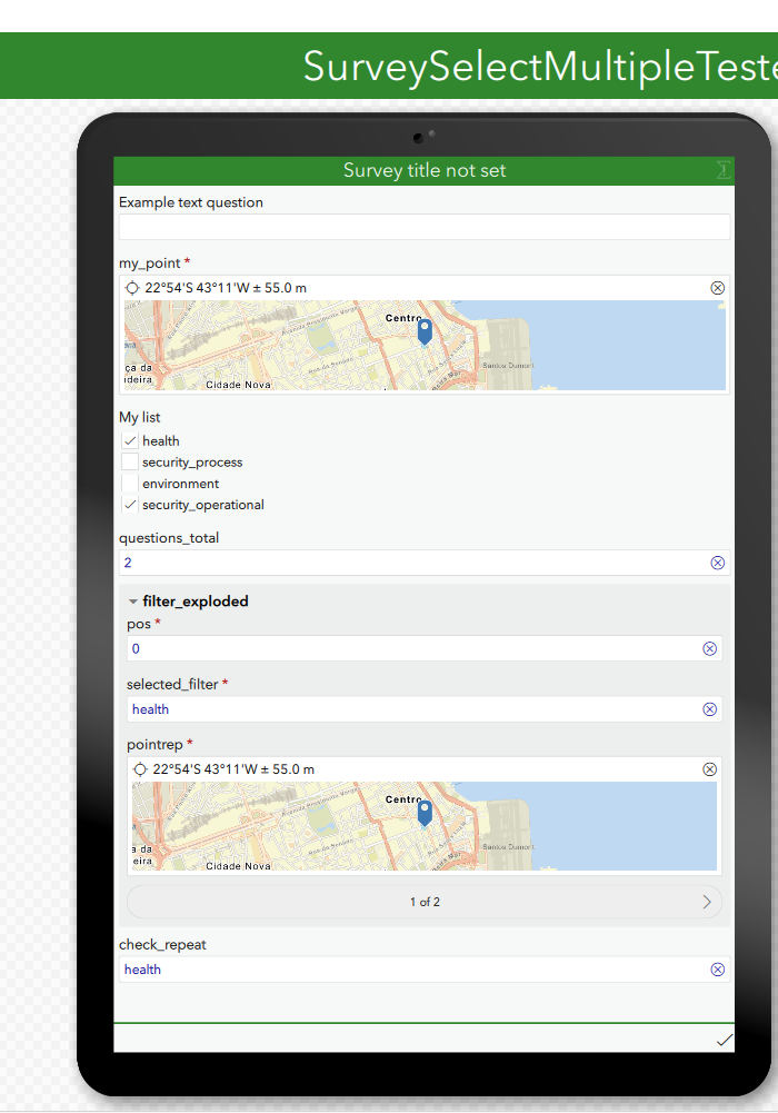

Hello, guys I have a survey where I`d like to explode some multiple selections to be possible to make some filters in dashboards latter.
The problem is they are getting empty.
The worst part is that is accepting submission of empty repeats. Is this design possible?
If it is a bug I will do an ETL in the back-end....but I think it might be a bug or something I might be doing.

Have you tried setting the repeat to be required? users could be just deleting the first record.
HildermesJoséMedeirosFilho
Hello, I did try it, but users changes in the multiple selection wont update the values in the repeat, so It didn't work at the end.
I suggested an ETL in the back-end or webhook....
