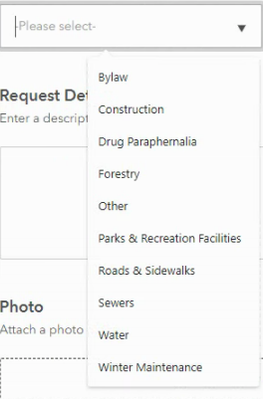

I have a Survey published to ArcGIS Online, created in Survey123 Connect 3.18.124.  There are a few questions on the survey that are of type "select_one" that are using the search function in the appearance column to get its values from a hosted feature layer in AGO.  That part works fine.  On the web survey, if I click inside the drop-down field I immediately see the available choices.  I can then click on one to select it.  If I then want to change that selection and click on the drop-down field again, there is no list of choices that appears.  I have to delete the text I entered first, and only then does the list of choices appear.
What I see when I first click in the drop-down field:

It's because of the search appearance. It's searching for the text currently in the cell. Which has been populated by your choice.
The inverse experience would be that if you click the list again, the text gets cleared, then you have to search for 'bylaw' again. This would be much more frustrating for other search questions that want to retain the text.
If it's too much for the users to delete their answer, you could consider not using the search appearance. It looks like there's only 10 choices in there? Other ways you could approach it.
