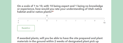

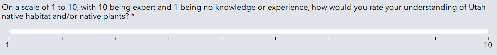

I'm struggling with the appearance of a range question in Survey123 Connect. When I view my survey in Survey123 Connect, the range question appears as expected: a scale from 1-10 with ticks. However, when I view the survey in my browser (Chrome or Edge), there are no ticks and the scale is difficult to understand. I have the "Appearance" column empty in my XLS Form.
Here's how the question looks in Survey123 Connect:
Here's how it looks in my browser:

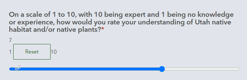

I published your XLSForm, unaltered, in Connect 3.17.55 and the range question is behaving as expected:
Maybe opening the form in an incognito tab or having someone else test it on another computer might help you with the problem.
