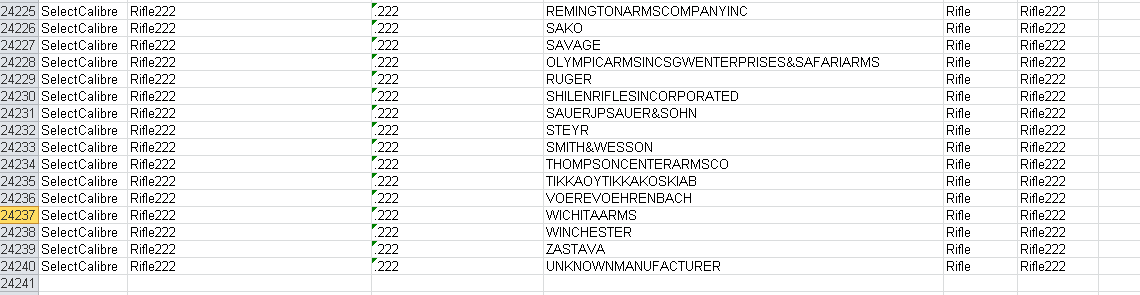

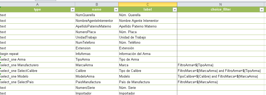

I create a survey with 5 select_one question and 4 choice filters. Each select_one question (type) filter next one based on previous selected. When i save and load my survey to Survey123 Connect app it works fine, but when i go to select_one questions and select any value in the dropdown list it takes long time to select it (10-15 sec). It happens in all of the select_one questions.  Anyone helps to make best performance in my survey?
Note: choice tab have 24,000 records.

Can you attach your xls form to this forum post? If you have 24,000 records, then maybe 10-15 seconds is normal. Also, for more visibility, you should move your post to the https://community.esri.com/groups/survey123?sr=search&searchId=7bd34b62-a150-48d7-9563-822ec8d69ac1&...‌ group space.
