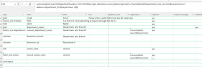

This is the screenshot of my XLS form. I get the department id of the selected department to use for query the sections, but it is not working. The data type of department_id in the layer is double. When I add the &where=department_id=${department_id} to the search() the section will show empty . What should I do?
