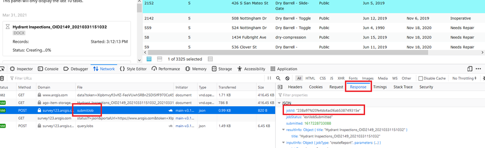

Hi @erica_poisson   150 records is well below the maximum limit.  We need to investigate what the issue is here. Please submit a new request with the web browser developer tools open and share with us the jobId that is failing.  You will want to open the Network tab, click on the submitJob request and check the JobId property within the Response of that request.  You can send the JobID directly to me via email or post here. Below is a screenshot with details to help click on the right places. Thanks.
