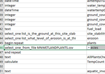

Working on a survey trying to allow a user to select from a list of plants, pulling from a .csv in the media file (line 46 in the form .xlsx). For the life of me I can't figure out why it isn't working. Probably something obvious.

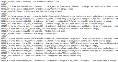

Hi Nicole, I noticed there were some extra lines in some of the items in the CSV file:
I removed the extra lines and was able to successfully pull data from the CSV file. I also saved it as the CSV UTF-8 format, removed all columns except for label/name for testing, and changed the appearance to minimal, and then back to autocomplete for testing. Please let me know if this helps!

In your form it looks like you've forgotten to reference the csv file after select_one_from_file. If you add the file name after this it should work - e.g. select_one_from_file filename.csv
NicoleCarter
Well that's what I thought too, but it still isn't working...
