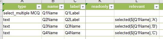

Hi Shawn,
That should be possible by using the Relevent column (when creating a survey, use the Advanced template which will give you all the column options):
Survey spreadsheet:
Choices spreadsheet:
