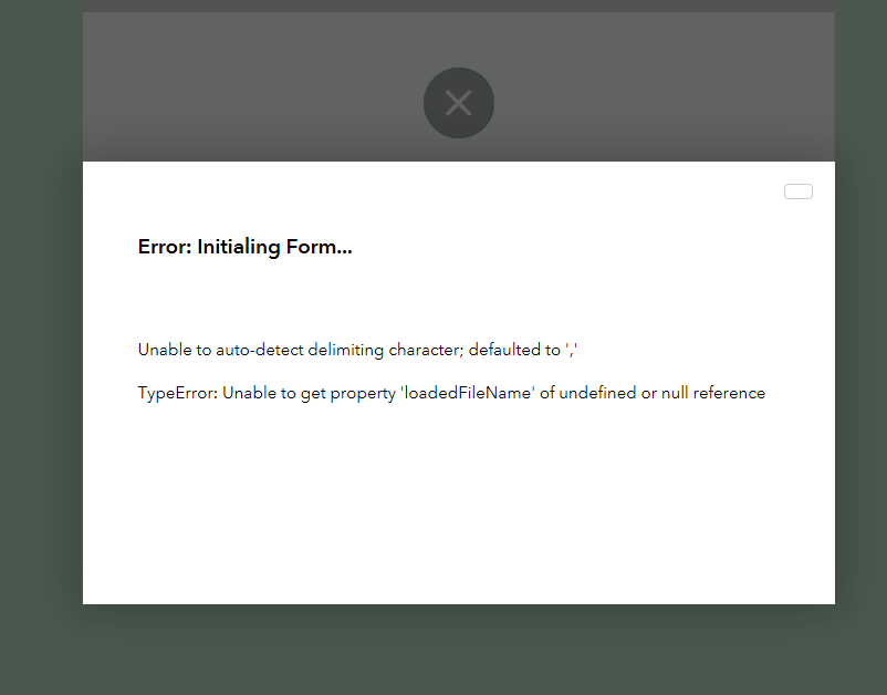

I have a survey123 form and it works (so far) well in the mobile app on iOS, the same form however on the Web Browser app in IE and Chrome fails to load with an error while accessing the content of a .csv file
this is the IE file error
The error in chrome
Chrome ErrorThe auth.csv below  file is as example - it only has commas as the delimiter....   I'm using this calculate on a username Type to lookup the csv file find a user and update their Authority field.
pulldata('auth','authority','name',${username})
Auth.csv

Hi Jonathon,
I had a look at your survey and csv file, and the issue appears to be caused by an extra line that exists in your auth.csv file. If you open the csv in a text editor (such as Notepad++) you will see an extra line that has no data in it (line 10). The field app appears to ignore this null line, but the web app is more sensitive to this null line:
After I remove this line the web app loads your survey correctly without error.

Hi Jonathon,
Phil.
jonathanharte
Thanks a mil Phil, sometimes the obvious is not so obvious 😞
Works a treat, thanks for taking the time to look at this for me ....  I'd be lost without this facility and the like of you guys supporting it.
