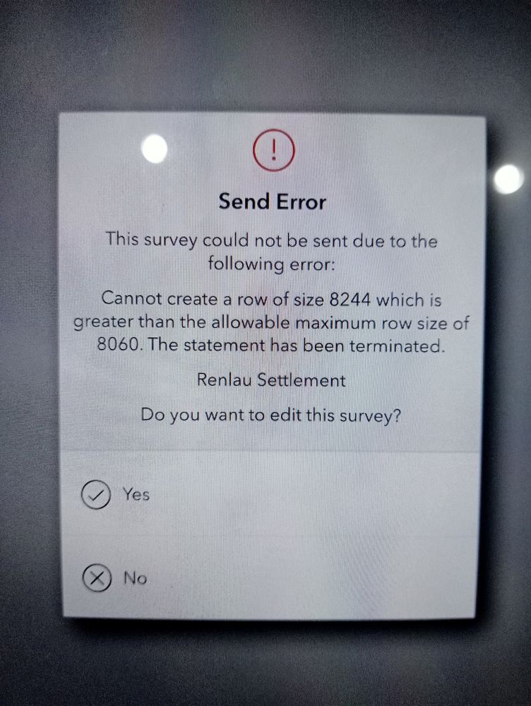

hi,
I am looking for advise to resolved this issue (see screen shot).
The send error occur when I tried to send my survey.
Send errorSend error
ChristopherCounsell
MVP Frequent Contributor
This appears to be a database level error suggesting that the row (data entry) is too long.
It could be tied to being too large a data entry, misconfigured fields, or missing corrupted fields.
It's not a common Survey123 error. If you need help narrowing it down further we'll need:
  • Survey XLSForm
  • Insight into how the service was created (from publish, manually, portal vs agol, what databse)
  • Insight into how the form is completed (URL schemes) and if it's specific to this submission or all surveys.
Reuben
hi Christopher,
Thanks for your respond.
We had an ArcGIS Enterprise for Organization account and the ArcGIS Survey 123
is created and stored in this account.
We haven't encountered this issue when we conducted the survey on web app.
