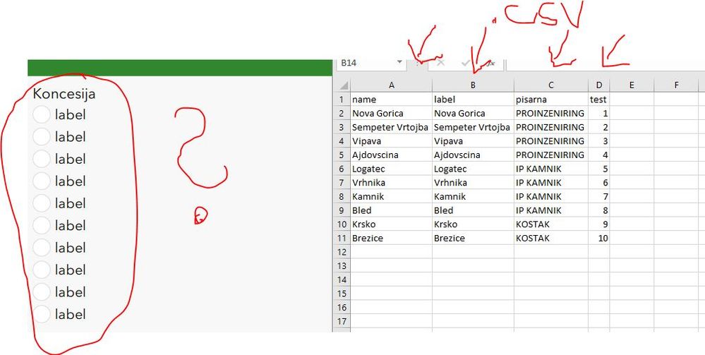

Hi,
i am unable to expose csv table - attributes into survey123. How can i set the proper field to display?
All i get is an 10x "label" option, witch is not on my list. I have 10 rows and 4 collumnes on csv file.

I've seen this before from a "proper CSV". The issue was a corrupt/poorly generated CSV. If you open the CSV and the Save As a brand new CSV, does the issue persist?
There could be a few different things at play here.

I agree with @abureaux  The CSV looks fine. Try exporting the CSV again using the CSV - UTF-8 option. Restart Connect too to avoid any caching issues.
MihaRobar
Thanks for the support. It was really trouble in csv file. In Europe default separator in .csv is ; instead of , . When i changed seprator in csv to "," labels were exposed correctly.
