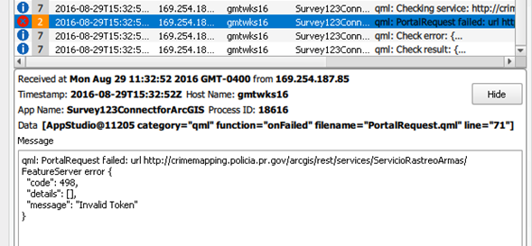

I have a form that i previously create and publish to my organization account, now i want to configure the submission url to use my feature service (hosted on my arcgis server) but when i put my service on the submission url column and try to republished again it doesn't work and i received an error message.

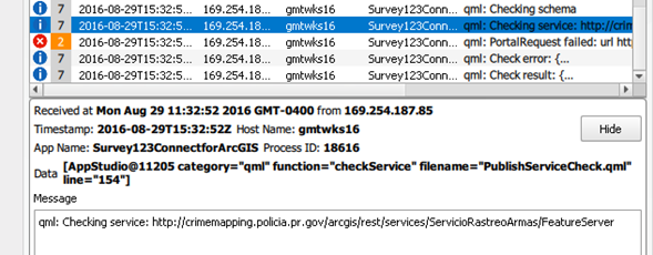

When i run the diagnostic tool in Survey123 and open it in Appstudio Console i see that the error occur because my form is attempting to validate my url and request a token (my service doesn't have security).

In that case, this would be a known issue that's currently being worked on. The problem is that essentially Survey123 is attempting to pass a token to a service that doesn't need it, and instead of recognizing that isn't necessary the application notices the token it's passing is invalid.

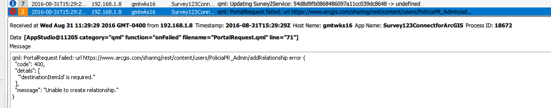

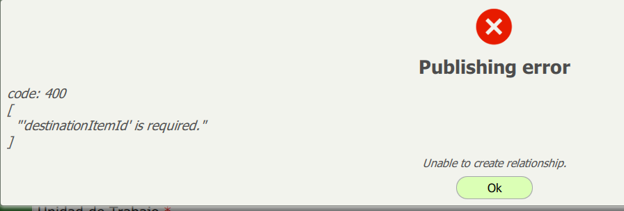

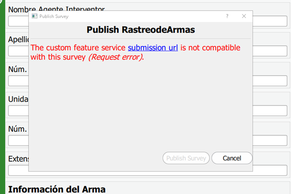

Today i'm able to pass the previous error that request token applying security to my feature service and then registered it in my arcgis online account with the user/password saved. Then i use the new url provide in my new feature service and when i republished the survey its works. But now i have a new error message:
In survey123:
In appstudio console:
