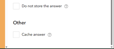

@MarcelBeckmann almost all the questions in a Survey123 form give you the option to "cache answer". It's a check box at the bottom of the question configuration.
When enabled, this will do exactly what you are looking for... soft of 😞. Unfortunately, this only functions in the web app, not the mobile app according to the help at:
https://doc.arcgis.com/en/survey123/get-started/faqcreatesurveys.htm#anchor11:~:text=For%20each%20qu...
