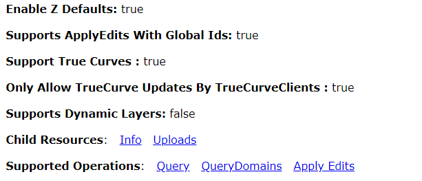

When we went to the service's REST endpoint, we saw that the
Supports ApplyEdits With Global IDs parameter was set to false. To resolve the issue, we added an attribute index on the GlobalID field, checking the box that said 'Unique.' Specifically, we Right-clicked on feature class from ArcCatalog > Properties > Indexes > Add Attribute Index > Select GlobalID field > checked the box next to 'Unique' > OK > Apply >OK). Then, we overwrote the service, confirmed that the supportsApplyEditsWithGlobalIds property from REST changed to True, and were able to successfully create a survey from it using Survey123 Connect.
