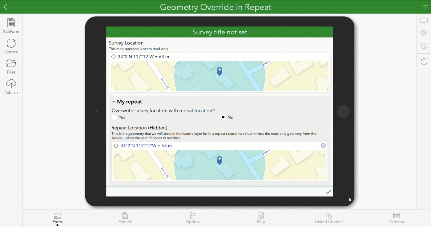

Hi Christina. I am not sure I totally follow your requirement here, but I gave this a try. You can download the XLSFile I attached to this message.  In short:
  • Added a read-only geopoint question to the survey. This question is populated by the Survey123 field app automatically and its value cannot be changed.
  • Added a repeat containing:
    • A yes no question
    • A geopoint question (I will call it A) with esriFieldType column set to null (presents the user a map, but the value of this question is not stored in the feature layer)
    • A geopoint question (I will call it B). For testing purposes, I show this question in the form, but you will want to set the value of this questions appearance to 'hidden'
  • If the user chooses yes in the yes_no question within the repeat, then:
    • We show geopoint A question so the user can define a new location
    • Then the geopoint question B gets this value and ignores the value from the survey read-only gepoint
  • IF the user chooses no in the yes_no question:
    • The geopoint question A is hidden
    • The geopoint question B value is set to the location of the survey
If this approach works for you, you may want to set the appearance on geopoint B to hidden.
