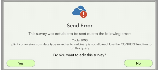

I have a tree inventory survey which has some collected data i would like to sync back to the survey 123 account, however, when I sent it, it is giving me an error.
I have attached the xls form below as well.
My main concern is since the survey is published already and if I republish it, will it loose the collected data. I would want to back up the data first although it is not being published from my tablet to online so how can I back the data or fix the issue.

Your 'utmtext' text question has a field type of EsriPointGeometryZ - this looks to be a one-off line error.  You'll need to republish this creating a new feature service, unfortunately.

Thanks for the reply, if I republish I would loose my data right, unless I write it down somewhere manually .
BrittneyGibbons1
Can you remove the field that is the wrong type and re-add it to the service before republishing your form? I had to do that for a text field that I had incorrectly mapped to an integer field. I removed the original integer field and then added it back with the same field name as a text field. I republished my survey with the correct field binding and then my forms were able to submit successfully.
Another alternative might be republishing the form using a submission URL that has the correct schema.
