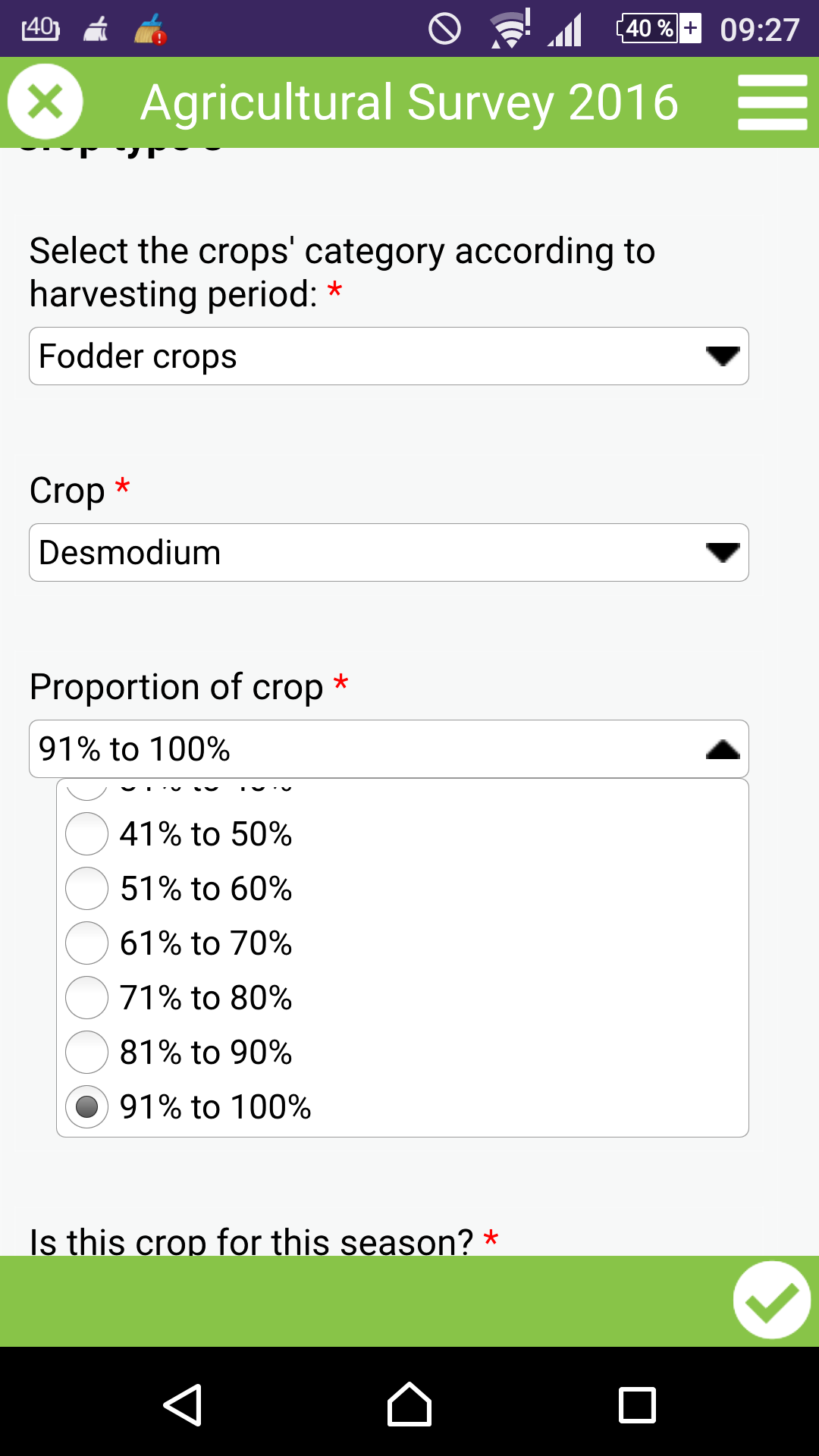

From trying again in order to send you some screen shots I found that choosing from a list of e.g. 10 entries the 8th entry (or above) will not show the chosen item. This is only the case for the field where I have a percentage range as a label, a number as the name. In contrast, for my crops list it works also with the list of 20 choices.
On the left you see that I chose the last value for the proportion. But as soon as the menu closes, the selection disappears. When I look back into the list, I can see which value was chosen but it doesn't show in the field.
Maybe you can reproduce it now. Thanks for looking into this.

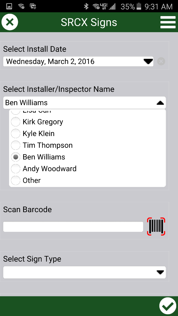

Hannah, i have attached a series of screenshots and the xlsx file for you. The choices are a simple select_one list with 10 and 5 choices respectively.
