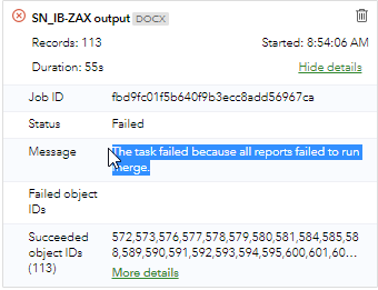

Hi,
If I make a simple template in word;
${name_element};${cabinet_qr_ext_scan};${cabinet_qr_int_scan};${longitude};${latitude};${comments_general}
On my S123 I place a filter , and I select merge (continious) , I get an error :
"The task failed because all reports failed to run merge."
How to solve this ?
jonow
I has this same error which ended up being caused by an invalid character within one of the records I was trying to generate a report for. Try generating a sample report with a different 20 records until you find the one causing the error. For my work the invalid character looked like [?] within one of the fields of the problematic record.
If you then remove the character it should all start working correctly.
