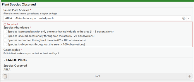

Weird mine does stop me from going to the next repeat on a required.
I do have a long standing idea posted to also do this for pages.  But repeats do stop me.  Is this in the app or web form?  What device?  Are you up to date?

Pages won't let me go to the next one on a required but Repeat let me go to the next one...

@KenBouchard  I can reproduce this behavior.
In the Survey123 mobile app, the 'required' check is done when you add a new record. Like @DougBrowning  describes.
In the Survey123 web app, the  check is done when you click on the Submit button (allowing you to have empty required fields and add a new repeat record)
I will create a note in the internal Esri development repo. However, I suggest to create an Esri Tech Support ticket for this so it gets officially logged.  Ideally, the behavior should be similar in both the mobile and web apps: check required fields before exiting the repeat record.
