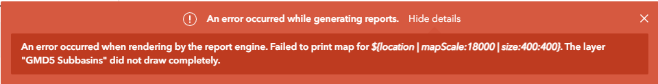

  1. I accessed the survey's data via AGOL and the data looked valid. I attempted to create a  "Preview sample report" to test that the data would properly load into the report template. I received the error below.

  4. I've disabled the "GMD5 Subbasins" layer in the web map to determine if it is a layer issue or something bigger.
  5. Other surveys that do not have a geopoint map within the report template process properly.
  6. However any survey that has a geopoint map embedded into the report template seems to result in the same error.
Let me know if there are additional troubleshooting steps other than "delete the survey / data" and restart.

When the subbasins were disabled in the web map, the survey report still fails. I should have clarified earlier, the troubleshooting steps noted previously did not work to get the survey reporting working.
The coordinate system for the subbasins layer, like others layers in the web map, is: Projected WGS 1984 Web Mercator
As for hidden layers in the web map, no layers are hidden. There are some that are invisible based on the map scale but none hidden by default. I "disabled" GMD5 Subbasins layer by hiding it.
To further check for issues, I removed the GMD5 Subbasins layer from the map completely. I still received an error, but for another layer within the same geodatabase hosted within our organization's AGOL. So I don't think it is specific to the layer.
I have confirmed that the web map and underlying geodatabases are available to everyone in the organization. To test this further, I have temporarily made the geodatabase public.
