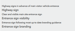

As you can see - the Hint is appearing above the related question when I would prefer it to appear below it. Is there a easy, obvious way of doing this? Without having to use Notes?

Thanks for your reply. I actually found out what was causing the issue. Any Group of questions in a Table-list switched the location of the Hint text to above the Label text for some reason.
I wanted to group the questions into a more matrix grid style so used Table-list but when you do, any questions with Hints, the location of the Hint moves above the Label.

The screenshots below show what I mean. The first is a group of questions in a field-list (the hint is below the question label like I would like). The second the same group of questions in a table-list (and the hint switches to above the question label)

Hints don't play well with table-list appearance (this is known behaviour). This is a bug IMO. But I am unsure if it's been logged.
