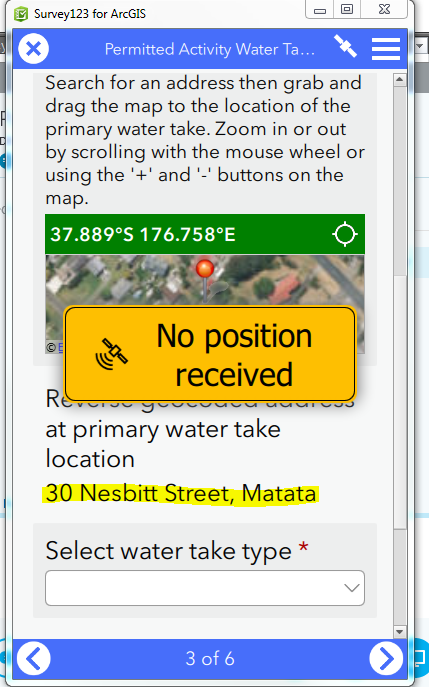

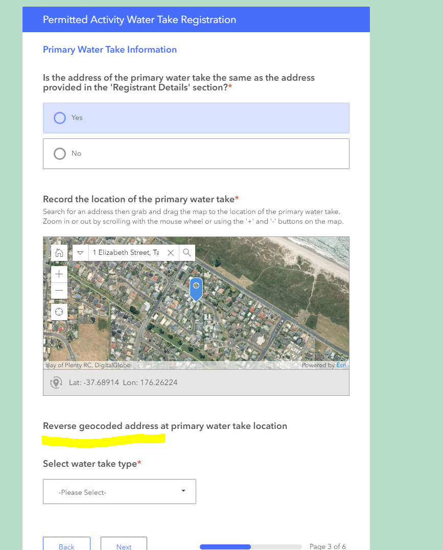

I was wondering if reverse geocoding using the pull down function published out of Survey123 Connects works in the the Survey123 web form. I have tested this in the Survey123 field app for desktop and it works but it does not seem to be pulling the location info from our geocoding service through the webform.

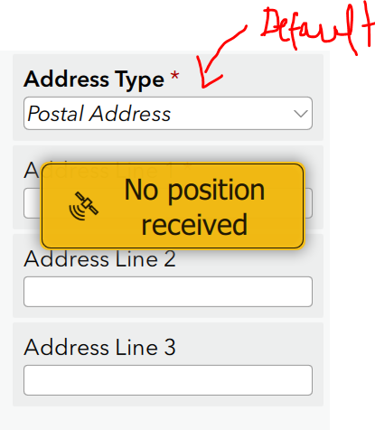

Another issue is the default value for a select_one type question is not working in the webform either when it is working fine in the Survey123 field app for desktop.

I can see an issue in the reverse geocode request - it is sending a token, causing a security error.

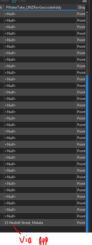

I have repeated the same test using the same address. 6 Mair Street, Matatā. See Object ID 51 and 52. I have entered similar data both in the webapp and in the desktop field app of survey123 and the results are different.
The X and Y lat long fields are populated everytime in both apps using the esri geocoder with simply the pulldata function but the reversegeocode.location and reversegeocode.adress.Match_addy only seem to be working when being run out of the desktop app (tested using both ESRI and our test LINZ geocoder).

The issue with regard to the token is a bug and we will look to fix it.
