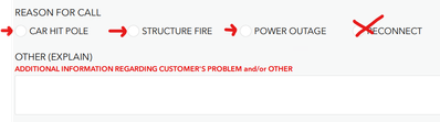

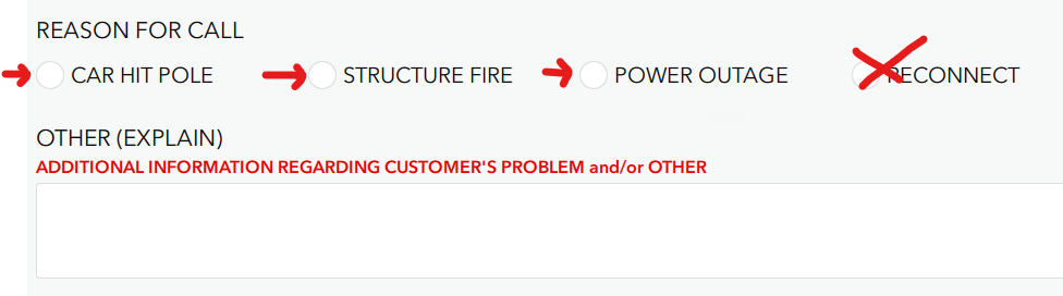

I am in the process of revamping and redesigning one of our more complex forms. Need to figure out if the user makes a specific selection, the following question becomes a required field.
Example:
If the user selects one of the 3 options marked with an arrow, the OTHER (EXPLAIN) free-entry section becomes required before moving on to the next page. However, if they select reconnect, the OTHER section doesnt become required. Also, Is there a way that IF they select one of those options, that field could go from minimized to automatically maximize indicating the user needs to fill it out.
Yes, multiple step multi-question problem I'm working on.
Appreciate any feedback or assistance.

Yes this is possible, you can add expressions in both the body::esri:visible (or relevant, but I've started to prefer the former) and required fields.
In this case since it's only one option that means it should not be shown or required I would do something like ${reason}!='reconnect' in those two fields.
