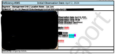

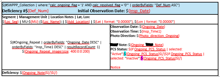

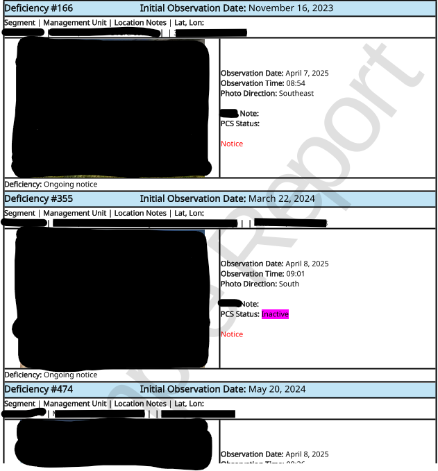

I am experiencing a duplication issue in my report template. For instance, using the merge (continuous) file option, the generated file will contain the report duplicated 5 times if I select 5 records to be displayed. I believe it has to do with the #SWPPP_Collection call at the top of the table. (SWPPP_Collection is the parent table & Ongoing_Repeat is the related table)
The goal is for the template to produce a seamless table containing all records indicated by the contingencies listed after #SWPPP_Collection, as seen in the screenshot below.
Any advice would be greatly appreciated.

Is there a reason you're calling the parent table SWPPP_Collection as a repeat table? If your survey and report template are pointing to the SWPPP_Collection table as the parent and then you call it as a repeat, I think that would explain why your report is duplicating itself.
Drop the entire ${#SWPPP_Collection} line and the last ${/} and see what happens.

Unfortunately I have tried that. When I keep the same file option (merge (continuous)), the following happens.
When I choose merge (next page), the report is not duplicated or stacked but I get one box per page & there is no way that I can figure out to filter for the necessary records. The goal is to have a seamless chart containing all specified records which is why I called on the parent table like I did, so I can dictate which records would show up in the report.
Please let me know if you have an alternative action to achieve this goal. I tried keeping the same line but removing the # & got the same results as when I removed the line completely.

I have unfortunately already tried that idea as well 😢 The only time the report duplicates is when I call the parent table as I did. The report generates exactly as I need it to minus the duplication.
The hurdles I'm facing are between figuring out a way to implement my current method of calling the parent table but without the duplicating, or finding another way to get the template to filter the parent table data before calling on the related table.
