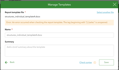

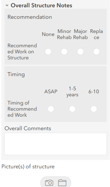

I would love some help! I am trying to create a report from my survey findings but I am stuck on the syntax for a couple questions. Can anyone tell me what I am doing wrong? I am not a Coder and a beginner with Survey123 as well. Thanks in advance. I took a few screenshots to try and show what I have now.
These are the questions in my survey -

I am sorry I forgot to include that part. I am getting an error when I try and upload my template.

missing a curly bracket here:
${list_recommendation (selected-at(${recommended_work})
Neal_t_k
MVP Regular Contributor
Not sure about the single quotes here, don't look quite right?
${list_timing} | (selected-at(${timing_of_recommended_work})
