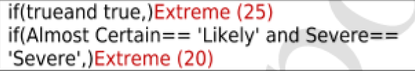

if(${flooding_risk== 'Almost_certain' }and ${flooding_impact== 'Severe'},)Extreme (25)
if(${flooding_risk}== 'Likely' and ${flooding_impact}== 'Severe',)Extreme (20)
result it is showing
I am expecting my result should print only "Extreme (25)" or "Extreme (20)" if its present in the record.
