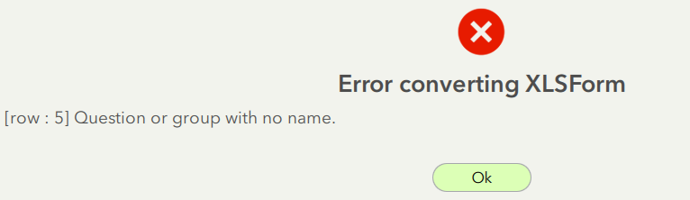

It's interesting that you say that because I had to put them in because when I remove the repeat name and label I get the following:

Can you attach your survey xls so I can take a look?
But using reserved words (start and end) as question names is likely to be one of the problems. Also you don't need give the end of repeats names or labels - only end repeat is required.
