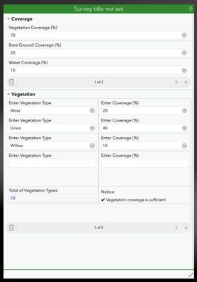

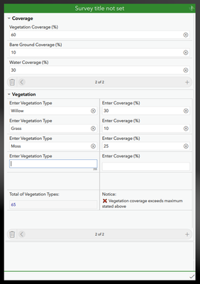

@Jonatanson_DUC  Ok I think I'm with you. When you say second repeat I am taking it to mean a whole other repeat group, going with this, my first recommendation would be to do away with the second repeat and calculate the vegetation % make up (which is currently handled by the second repeat), from within the first repeat. Unless you specifically need the second repeat for some reason, this is a much easier approach. Given that you are asking though, I assume you really want the second repeat.
You can't index another repeat from within a repeat, that's just a limitation, so you're going to need to build your indexed-repeats, outside of the second repeat, and then refence back to it.
Again, you will save yourself a lot of lines and calculations if you just combine the two repeats into one. but it is possible (albeit not especially dynamic) to do it with two repeats. Do the screenshots below look something like what you are trying to achieve? (comments change, showed two repeats)
Overall for what it sounds like you are trying to achieve, I would do a single repeat, have your ground cover questions, be realistic about how many different ground cover types the area is likely to be split into (doesn't have to cover infinite options), lets say 20 options for ground cover types (seems like a lot to me but idk). Have each question visible only if the previous one is answered. That way the survey isn't busy for the user. Then after that section (you can group that section if you like), have another group. This new group will be your vegetation make-up. Again, have 20 odd questions(?), asking for the type of vegetation and the percentage of the area they make up). then have your running total below that, and your comment about sufficient coverage or not. Having repeats trying to reference each other gets very long with the calcs.
Hopefully that helps, or maybe i've completely misunderstood.
