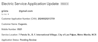

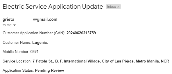

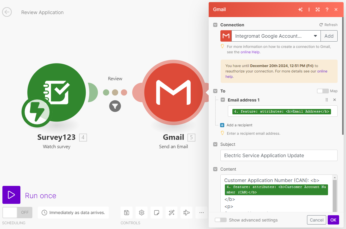

I created an automated workflow using Make.com, and it worked when the application was submitted (using Electric Service Application Form), I received an email.
But when I edited the application status (from Pending Review to Approved) using Electric Service Application Review Form there's no email received.
The scenarios in Make.com are same configuration, the only difference between the two are the used form.

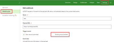

Hello @mdg
In the Survey123 website under the settings for the Electric Service Application Review Form select Webhooks then edit the webhook that is attached to that form. Under Trigger events ensure that "Existing record edited" is enabled.

mdg
Hi @ZacharySutherby
Thank you for your response. I removed the filter from the New Application Flow (Electric Service Application Form), and it worked in Integromat environment—I received an email confirming the approved status when I submitted the Electric Service Application Review Form. (Review Application Flow) without configuring in Webhooks Settings.
I am encountering the same issue in Power Automate as described above (my first concern). 😭
