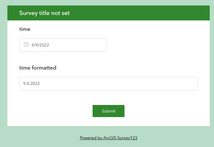

IsmaelChivite
Esri Notable Contributor
Hi. The problem is the % sign at the end. Survey123 Connect is more tolerant than the web app. Try
format-date(${mytime},'%e.%n.%Y') instead.
