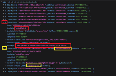

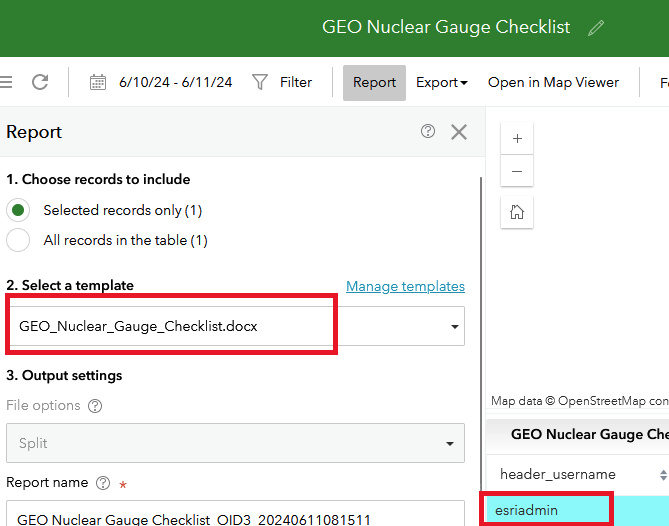

S123 reports aren't running. I'm logging a support case...
This happened overnight. Portal and Surveys Site are all online and accessible.
EDIT: This also is happening directly from the Surveys Site (worked less than 12 hours ago):
EDIT2: According to my IT, nothing changed overnight on our security settings.
EDIT3: In case it matters. Environment is Enterprise 11.0

abureaux
MVP Frequent Contributor
This just got a whole lot weirder... The error is still persisting; however, I am getting esriJobSucceded now as well! I got 7 failures (all related to templateItemId), but then the report was successfully generated:
I had to dig around the Network traffic for the URL, but when I pasted it into my browser, I got my report.
Again, nothing is working since that first error ends all processes (Power Automate and Esri's reporting service). But I can clearly see that is is in fact finding and using that templateItemId.
