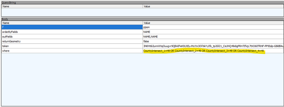

This works great in the Survey123 Connect app. When I look at the request in Fiddler all looks correct and the expected values show up in the drop down.

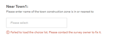

However, when I publish the survey and open it in the web app, I get the following error:

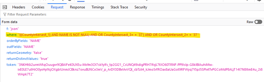

It's failing to load because it appears that the where parameter for the request makes no sense.
