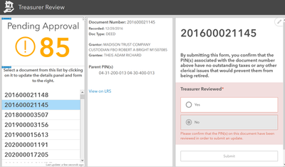

Create a dashboard that lists the features in this view with a linked Embed element that goes to the URL "https://survey123.arcgis.com/share/<survey-itemID>?mode=edit&globalId={globalid}&hide=theme,header,f..."
Share that dashboard with supervisors only, perhaps through group sharing settings. If your supervisors are specific to certain departments, you can repeat this process for each one. In my org, our County Treasurer and Clerk each have their own dashboards like this:

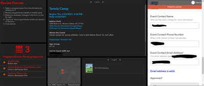

I have everything set up, but when a supervisor attempts to submit any changes on the embedded form, it gives an error that says "Failed to submit" without any further information.
Have you ran into this issue at all?
jcarlson
MVP Alum
Ah, that's probably the sharing settings. Even if your "supervisors" layer is editable, it needs to be shared publicly to be edited by non-Creator user types.
We've never had anyone spam our view layers, but it's another reason to use the embed in the dashboard. Even though the survey and view layer are public, the dashboard isn't, so there's at least a little more control.
