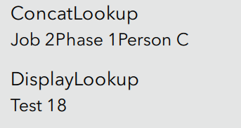

Thank you for passing along the sample XLSForm and CSV! I've tested on my end with Connect 3.13.251 and I am seeing the pulldata() function bring in the correct information:
