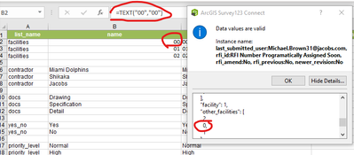

I just recently started seeing this problem in the Field App, but believe the Web Form to be OK.  I can't say if it's new or not, but my users just started reporting that the leading zeros are being removed from  select_one and select_multiple questions.
I tried a few things like setting the TEXT field type and using the =TEXT() function, but when I test in connect, I can see the values are coming in as integers still, with the leading zero dropped.  See screenshot below.  Is there another way to do this?
StevenDel_Castillo
Hi James,
After using =TEXT() will the leading zeros still be there after saving, closing and reopening the file?
