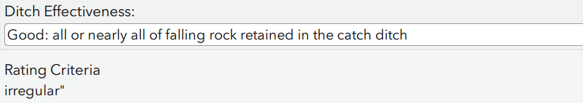

I am trying to use pulldata function to populate some of the fields. I am getting error every time when I add new column in the pulldata it is changing first value of the previous question.
e.g. I am trying to populate rating criteria which is depend on the various field added before, (refer to the snapshot of my csv below). So if I choose "ditcheffectiveness = Good" I get "ratingcriteria = 3" which is correct, but when I add new column (or insert a new column) before "ratingcriteria" the next time when I choose "ditcheffectiveness = Good" instead of getting "ratingcriteria = 3"  I get "ratingcriteria = irregular" (which is the value of rockfriction").  It has been showing this error only for first option for the rest it shows correct ratingcriteria value.So to get the correct value either I have to delete ratingcriteria or sometimes both the coulmn and have to add it again. It is annoying as I have few more columns to be added to the csv.

Hi Anu,
The problem is that you have commas (,) in your CSV data. Currently the pulldata() function does not support a comma in the data of the CSV. Therefore you columns of data are being separated in the wrong place and the quotations " are being included in the data returned from the CSV.
We have an open issue for this and hope to support it in the future, I have updated your comments against this issue. In the meantime you will need to remove the commas from your data if you want it to work as expected.

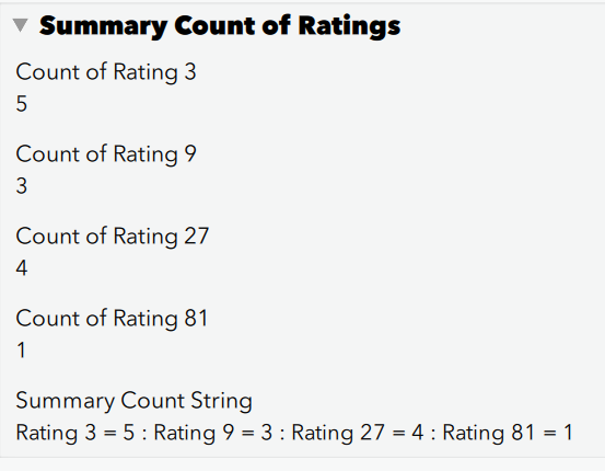

Hi Anu,
Thanks for sending me your survey xls, after having a closer look I realised we don’t need as many extra fields compared to what I mentioned in my previous reply. We only need 4 extra note fields with 13 IF statements in each (one IF statement for each answer). If you then want to combine the counts into one string output summary field, add an extra note field, so 5 fields total.
If you create the note fields with names and calculations, this means they will get added to your feature service as fields. If you do not want to store them as additional fields, you need to either remove the name from these notes (but then we can't use them for concat string) or set the bind::esri:fieldType as null. Alternatively, if you do not want to display them on survey but do want to store them in feature service, you could set them to be hidden fields.
I have emailed you the updated xls file as an example. Below is one of the calculations I have used for rating 3 count:
if(${field01}="3",1,0) + if(${field02}="3",1,0) + if(${field03}="3",1,0) + if(${field04}="3",1,0) + if(${field05}="3",1,0) + if(${field06}="3",1,0) + if(${field07}="3",1,0) + if(${field08}="3",1,0) + if(${field09}="3",1,0) + if(${field10}="3",1,0) + if(${field11}="3",1,0) + if(${field12}="3",1,0) + if(${field13}="3",1,0)
And this is what it should look like in your survey:
Hope this helps and is what you were after.
