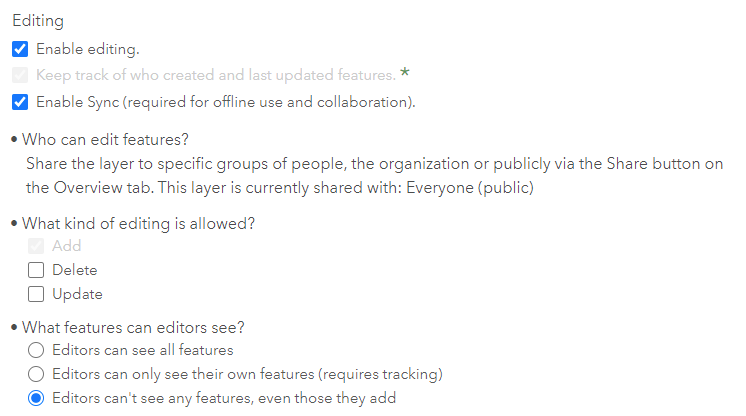

With editor tracking settings, you can configure a public service to not expose existing data.
This maintains data integrity, while allowing other users to contribute to the survey.

Very interesting - this is for general purpose feature layers it looks like.  But I assume the same is available with Survey123.
jcarlson
MVP Alum
I mean, once you create the survey, it creates a "general purpose feature layer" to hold the survey responses. While the means of editing can differ, the underlying service is no different.
