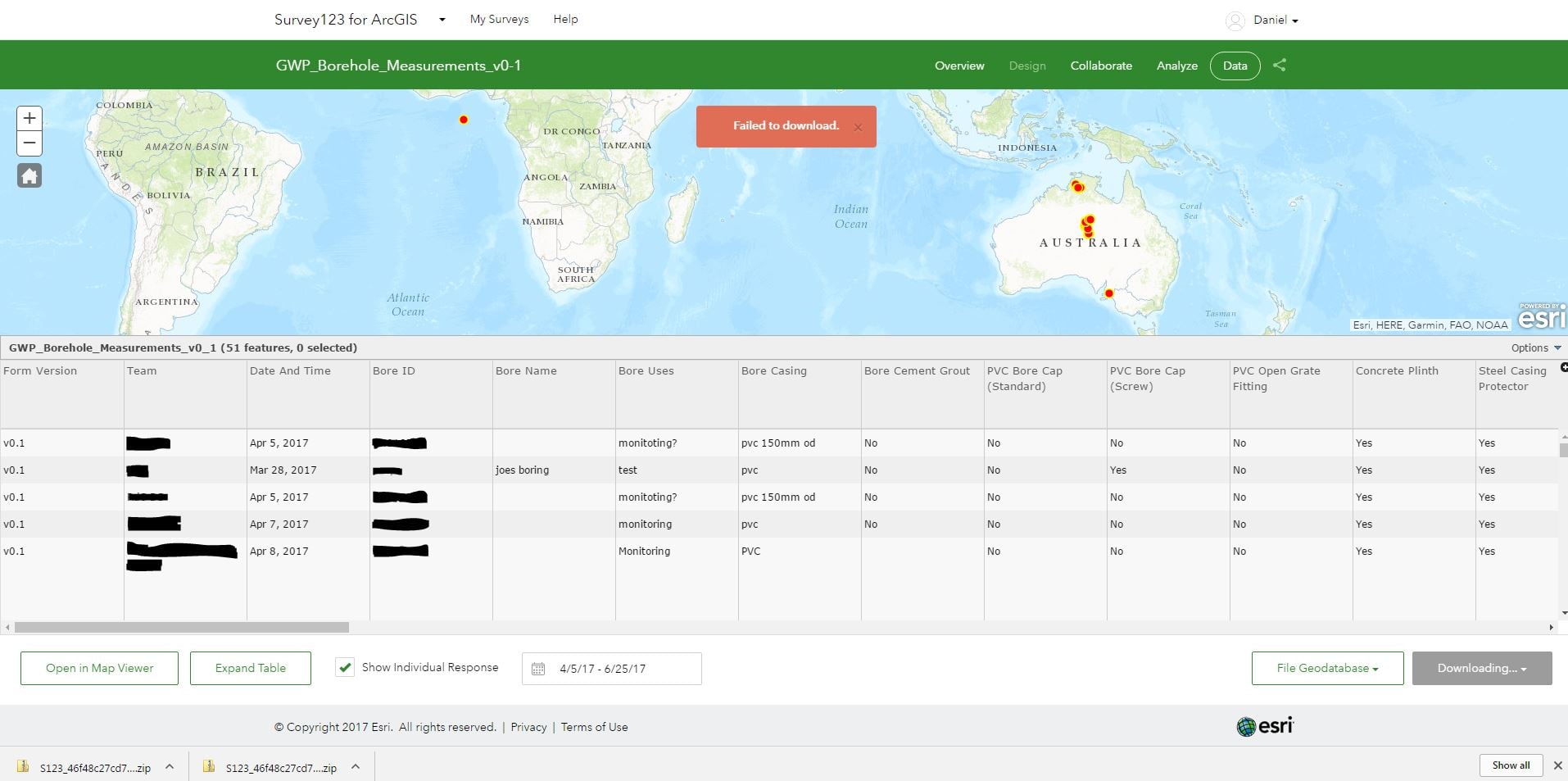

Hi All, I have been trying to download a survey as a fGDB but I just get a "failed to download" error message (See below).
The form has repeats and the ability to upload images, hence why I need to download it as a fGDB. I am able to download this survey as a shapefile and as a CSV (although not helpful for the photo attachments or the linked tables).
I initially thought that this may have been a bug in Survey123's web portal or AGOL, but I am able to download fGDB for other surveys that have both attachments and repeats.
Anybody have any idea what may be the cause of this or how I can solve/work around it? It would be most appreciated I assure you!

Hi all, so I managed to solve the problem.
I had a '-' symbol in two of my field names. This is an illegal character, but Connect doesn't pick it up when you save your XLSX form. This doesn't seem to be an issue for CSV, SHP formats or a Hosted Feature Layer in AGOL.
I have removed the symbol and republished as a new version and i'm able to download as a fGDB without any problem. Unfortunately I cannot update the existing survey as it wipes the data (tested this on a new version just to be safe - good move!), so if anybody has any tips on updated an attribute name in a hosted feature layer that would be great!
