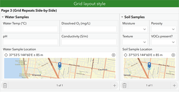

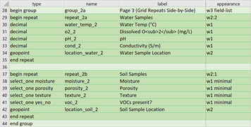

I tried to apply exactly the same procedure in thoses documents but I struggle to adapt the number of column for each element in a group. I would like that some elements of a group are splitted in 2 colums, and some to take the whole width of the page (1 column). This is a successful exemple from the documentation of what I am precisely trying to do :
GUID-7DF0D26E-23E9-45E5-9A60-D94942213518-web.pngGUID-4DD10EB2-7697-48FF-B916-046E66965EC5-web.png
